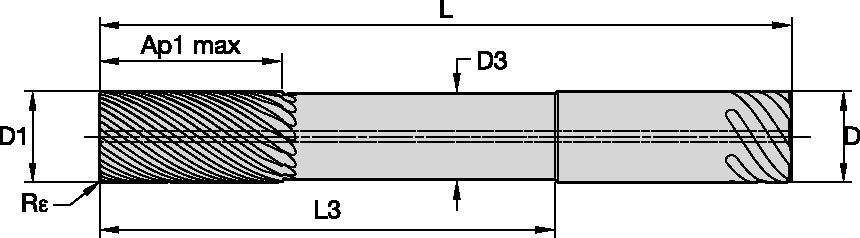

- RSM II • Radiused • Multi-Flute • Internal Coolant • Necked • Plain Shank • Inch

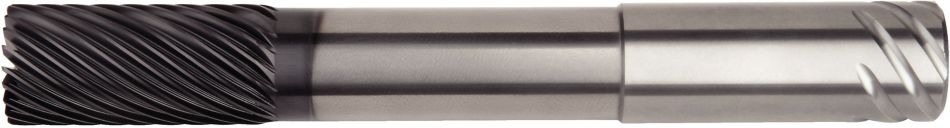

RSM II Solid Carbide End Mill for Finishing of Stainless Steel and High Temperature Alloys
- RSM II solid carbide end mills feature unequal flute spacing for chatter-free machining.
- Eccentric relief grind for higher cutting edge stability and higher feed rates.
- Designed for high-speed peel milling strategies with secure chip formation and chip evacuation in deep cavities.
- Through Coolant - Solid End Mill
- Helix Angle: 36°
- Tool Dimensions: Flute Configuration: X (variable)
- Corner Style: Corner Radius
- Side Milling/Shoulder Milling: Fine Finishing
- Side Milling/Shoulder Milling: Finishing
FSDE.. • Multi-Flute with Neck • Inch
