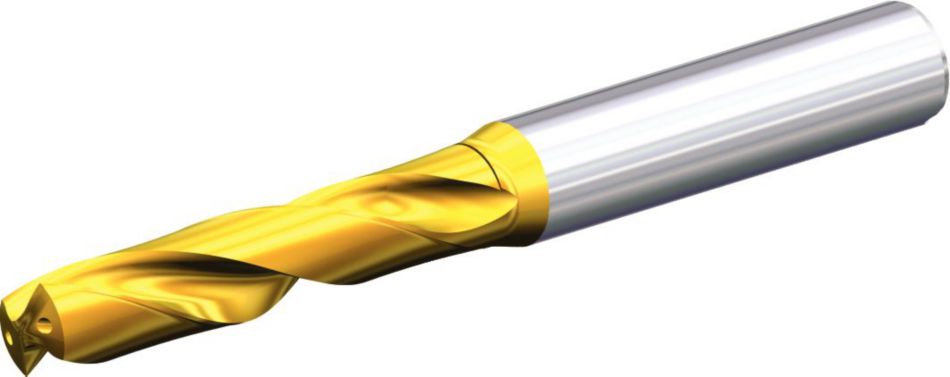

Drawings for 4099914
Material Number4099914
ISO Catalog IDB211A14500HP
ANSI Catalog IDB211A14500HP
GradeKCM15
[D1] Drill Diameter M 14.5 mm
[D1] Drill Diameter M 0.5709 in
[L] Overall Length 133 mm
[L] Overall Length 5.2362 in
[L3] Flute Length 83 mm
[L3] Flute Length 3.2677 in
[L4] Maximum Drilling Depth 63 mm
[L4] Maximum Drilling Depth 2.4803 in
[L5] Drill Point Length2.698 mm
[L5] Drill Point Length0.1062 in
[LS] Shank Length 48 mm
[LS] Shank Length 1.8898 in
[D] Adapter / Shank / Bore Diameter16 mm
[D] Adapter / Shank / Bore Diameter0.6299 in
  • DrillingDrilling
  • Tool Dimensions: 2flute/2margin/coolantTool Dimensions: 2flute/2margin/coolant
  • DIN number 6535DIN number 6535
  • DIN number 6537DIN number 6537
  • Drilling Depth: 3xDrilling Depth: 3x
  • Drilling Depth: 5xDrilling Depth: 5x
  • Drilling Depth: 8xDrilling Depth: 8x
KCM15
KCM15
Composition: Nanostructured PVD TiAlN coated fine-grain carbide with a golden TiN top layer for better wear identification and superior surface finish.
Application: A state-of-the-art surface condition enhances low adhesion potential to stainless steel materials and offers superior chip evacuation even in low-pressure coolant applications. Applicable for stainless steel and high-temperature resistant materials.
  • HP Beyond drills with through coolant for stainless steel.
  • Material-specific SC drill offering high performance and long tool life in regular steel and titanium materials.
  • By combining unique Kennametal technologies, such as the HP point, flute geometry, and a new Beyond grade technology into one tool, the B21_HP is the ultimate high-volume production tool.
  • HP point enables high feed rates by progressive rake angle.
  • KCM15™ Beyond grade is a nanolayer, TiAlN-based coating with high wear resistance and low adhesion to stainless steel materials.
  • The highly polished surface ensures superior chip evacuation even when low-pressure coolant is applied.
