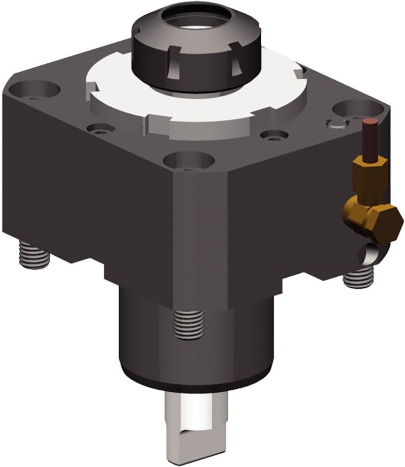

Driven Tool Axial • ER™ • TACU002ER32DA61301864, TACU002ER32DA61301865, TACU002ER40DA61301840, TACU002ER40DA61301841
DMG Mori • Driven Tool Axial • ER™ • MMC 002
Material Number6589004
ISO Catalog IDTACU002ER32DA61301864ANSI Catalog IDTACU002ER32DA61301864
Turret Adapted Clamping Units Driven Tool Axial • ER™
Turret Adapted Clamping Units Driven Tool Axial • ER™+0
[CST] Catalog Collet SeriesER32
Machine Mount Code002
[B2] Overall Width 149.9 mm
[B2] Overall Width 5.9016 in
[D] Adapter / Shank / Bore Diameter59.9 mm
[D] Adapter / Shank / Bore Diameter2.3583 in
[D11] Lock Nut Diameter50 mm
[D11] Lock Nut Diameter1.9685 in
Lock Nut Diameter [DLN_2]85 mm
[DLN_2] Lock Nut Diameter 23.3465 in
[H2] Overall Height 108 mm
[H2] Overall Height 4.252 in
[L] Overall Length 183.5 mm
[L] Overall Length 7.2244 in
[L1] Gage Length90 mm
[L1] Gage Length3.5433 in
Torque Machine Spindle Nm100
Coolant Pressure Bar70
Coolant Pressure PSI1000
Coolant DeliveryI/E
[CS1] Coolant Supply Exit SizeM12X1 & G 1/8
Max RPM6000
Weight Kilograms7.77
Torque Newton Meters136
Torque Foot Pounds100
  • ER Solid ColletER Solid Collet
  • Collet - ER DIN 6499Collet - ER DIN 6499
Machine Series:
  • NL/NLX 1500-4000 MC/Y/SMC/SY
  • NLX 4000 (High Torque Milling)
  • NT 4200-5400
  • NZX 2500 (12 Station Turret)
