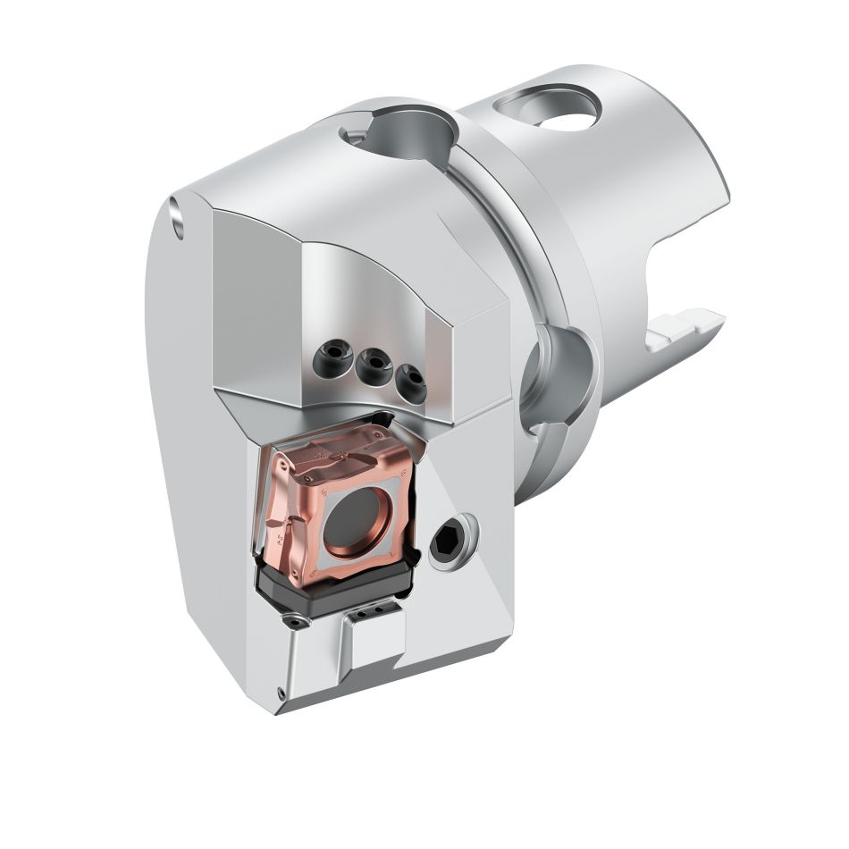

FIX8™ • Toolholder • KM50 • PCBN • 75° • Through Coolant
Heavy-Duty Turning • Quick Change Adaptor
Material Number6939713
ISO Catalog IDKM50TSPCBNR19FIX8HPCANSI Catalog IDKM50TSPCBNR19FIX8HPC
FIX8™ KM50TSPCBNR19FIX8HPC Toolholder 6939713 - Kennametal

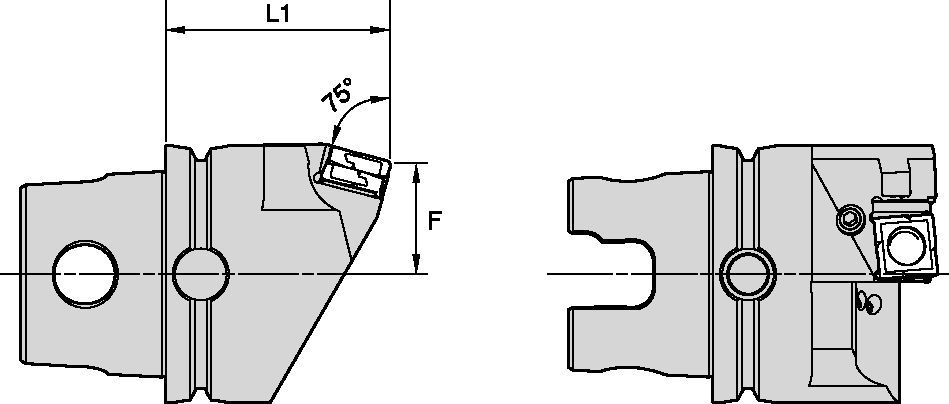

Drawings for 6939713
[CSMS] System Size Machine SideKM50TS
[L1] Tool Length 60 mm
[L1] Tool Length 2.3622 in
[F] F Dimension 20.539 mm
[F] F Dimension 0.8086 in
Gage InsertCNUX191016R
  • Eight cutting edges per insert
  • Precision 3D coolant technology supplied directly to the cutting edge
  • Low cutting forces and excellent chip control
  • Heavy-duty chip geometry for the largest feed rates
  • High cutting-edge edge strength, rigid clamping system
