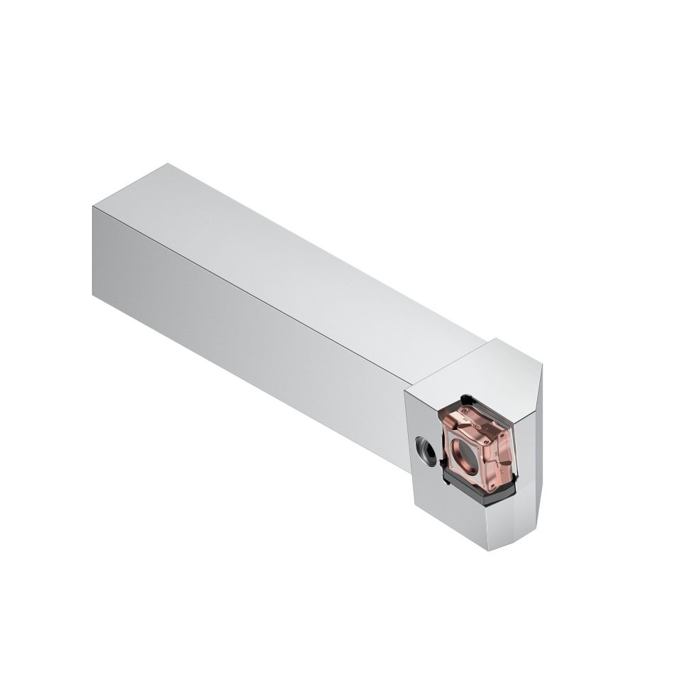

FIX8™ • Toolholder • PCJN • -3° • Inch
Heavy-Duty Turning • Square Shank
Material Number6913102
ISO Catalog IDFIX8PCJNR206DANSI Catalog IDFIX8PCJNR206D
FIX8™ FIX8PCJNR206D Toolholder 6913102 - Kennametal
FIX8™ FIX8PCJNR206D Toolholder 6913102 - Kennametal+0

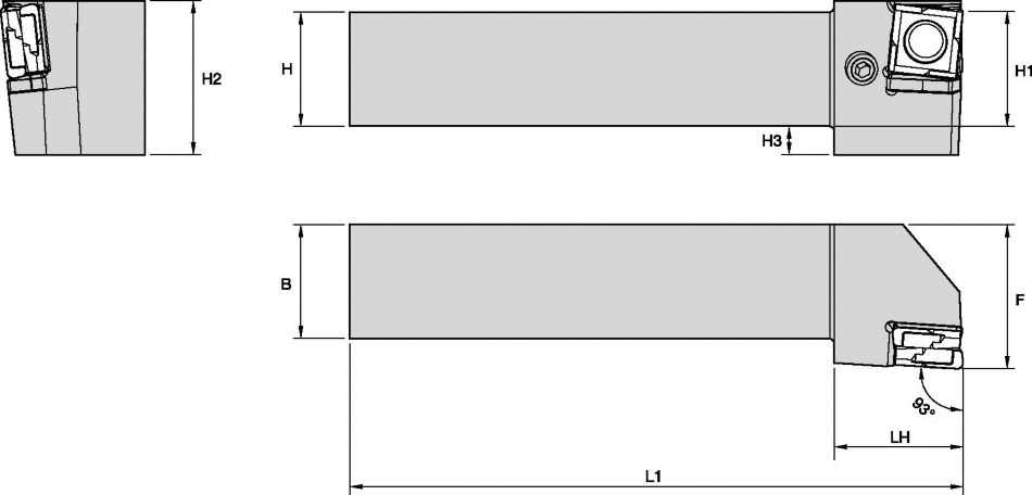

Drawings for 6913102
[H] Shank Height 31.75 mm
[H] Shank Height 1.25 in
[H1] Cutting Height31.75 mm
[H1] Cutting Height1.25 in
[H2] Head Height 38.75 mm
[H2] Head Height 1.5256 in
[H3]Head Bottom Offset 8 mm
[H3]Head Bottom Offset 0.315 in
[B] Shank Width 31.75 mm
[B] Shank Width 1.25 in
[L1] Tool Length 152.4 mm
[L1] Tool Length 6 in
[LH] Head Length 36 mm
[LH] Head Length 1.4173 in
[F] F Dimension 38.1 mm
[F] F Dimension 1.5 in

  • Eight cutting edges per insert
  • Precision 3D coolant technology supplied directly to the cutting edge
  • Low cutting forces and excellent chip control
  • Heavy-duty chip geometry for the largest feed rates
  • High cutting-edge edge strength, rigid clamping system
