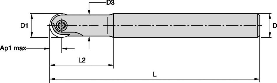

Drawings for 2877383
Material Number2877383
ISO Catalog IDKDMB32R240A32HNC
ANSI Catalog IDKDMB32R240A32HNC
[D1] Effective Cutting Diameter32 mm
[D1] Effective Cutting Diameter1.26 in
[D] Adapter / Shank / Bore Diameter1.2598 in
[D3] Neck Diameter 28.6 mm
[D3] Neck Diameter 1.126 in
[L2] Head Length 105 mm
[L2] Head Length 4.1339 in
[L] Overall Length 240 mm
[L] Overall Length 9.449 in
[L1] Gage Length240 mm
[L1] Gage Length9.449 in
[AP1MAX] 1st Maximum Cutting Depth16 mm
[AP1MAX] 1st Maximum Cutting Depth0.6299 in
Number of Inserts1
[Z] Number of Flutes2
Coolant SupplyY
Maximum Ramping Angle3
Max RPM30000
Gage InsertKDMB32.
