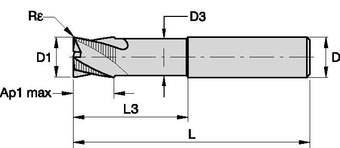

Drawings for 2625716
Material Number2625716
ISO Catalog IDF3BA1200ADL40E360
ANSI Catalog IDF3BA1200ADL40E360
GradeK600
[D1] Effective Cutting Diameter12 mm
[D1] Effective Cutting Diameter0.4724 in
[D] Adapter / Shank / Bore Diameter0.4724 in
[D3] Neck Diameter 11 mm
[D3] Neck Diameter 0.4331 in
[AP1MAX] 1st Maximum Cutting Depth15 mm
[AP1MAX] 1st Maximum Cutting Depth0.5906 in
[L3] Usable Length36 mm
[L3] Usable Length1.4173 in
[L] Overall Length 83 mm
[L] Overall Length 3.2677 in
[Re] Corner Radius 0.5 mm
[Re] Corner Radius 0.02 in
[Z] Number of Flutes3
