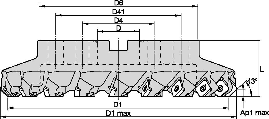

Drawings for 3020059
Material Number3020059
ISO Catalog IDKSSM400SE2045C5
ANSI Catalog IDKSSM400SE2045C5
[D1] Effective Cutting Diameter101.6 mm
[D1] Effective Cutting Diameter4 in
[D1MAX] Maximum Cutting Diameter122.502 mm
[D1MAX] Maximum Cutting Diameter4.823 in
[D] Adapter / Shank / Bore Diameter31.75 mm
[D] Adapter / Shank / Bore Diameter1.25 in
[D6] Hub Diameter 73.02 mm
[D6] Hub Diameter 2.875 in
[L] Overall Length 50.8 mm
[L] Overall Length 2 in
[AP1MAX] 1st Maximum Cutting Depth9.59 mm
[AP1MAX] 1st Maximum Cutting Depth0.377 in
Number of Inserts8
Weight Pounds4.09
Max RPM2700
