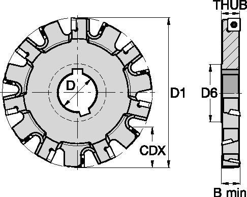

KSSM™ 12 • Slot Mill with Arbor Mount • Fixed Cutting Width 1/2" • Neutral Cutting • Inch
Slot milling cutter for full slot milling in multiple materials
SAP Material Number 2629785
ISO Catalog Number KSSS800ASD43N750
ANSI Catalog Number KSSS800ASD43N750
[D1] Effective Cutting Diameter 203.2 mm
[D1] Effective Cutting Diameter 8 in
[D] Adapter / Shank / Bore Diameter 50.8 mm
[D] Adapter / Shank / Bore Diameter 2 in
[D6] Hub Diameter 73.152 mm
[D6] Hub Diameter 2.88 in
[CDX] Radial Maximum Depth of Cut 64.567 mm
[CDX] Radial Maximum Depth of Cut 2.542 in
[THUB] Hub Thickness 16.916 mm
[THUB] Hub Thickness .666 in
[BM] Cutting Width Minimum 18.77 mm
[BM] Cutting Width Minimum .739 in
Number of Inserts 18
Number of Effective Cutting Edges on Face 9
Max RPM 8150
Weight Pounds 6.58
  • Slotting: SideSlotting: Side
P Steel
M Stainless Steel
K Cast Iron
N Non-Ferrous
S High-Temp Alloys
H Hardened Materials
  • Cutter body features two keyways for staggered arbor mounting.
  • Use right-hand and left-hand inserts for best possible wall surface finish.
