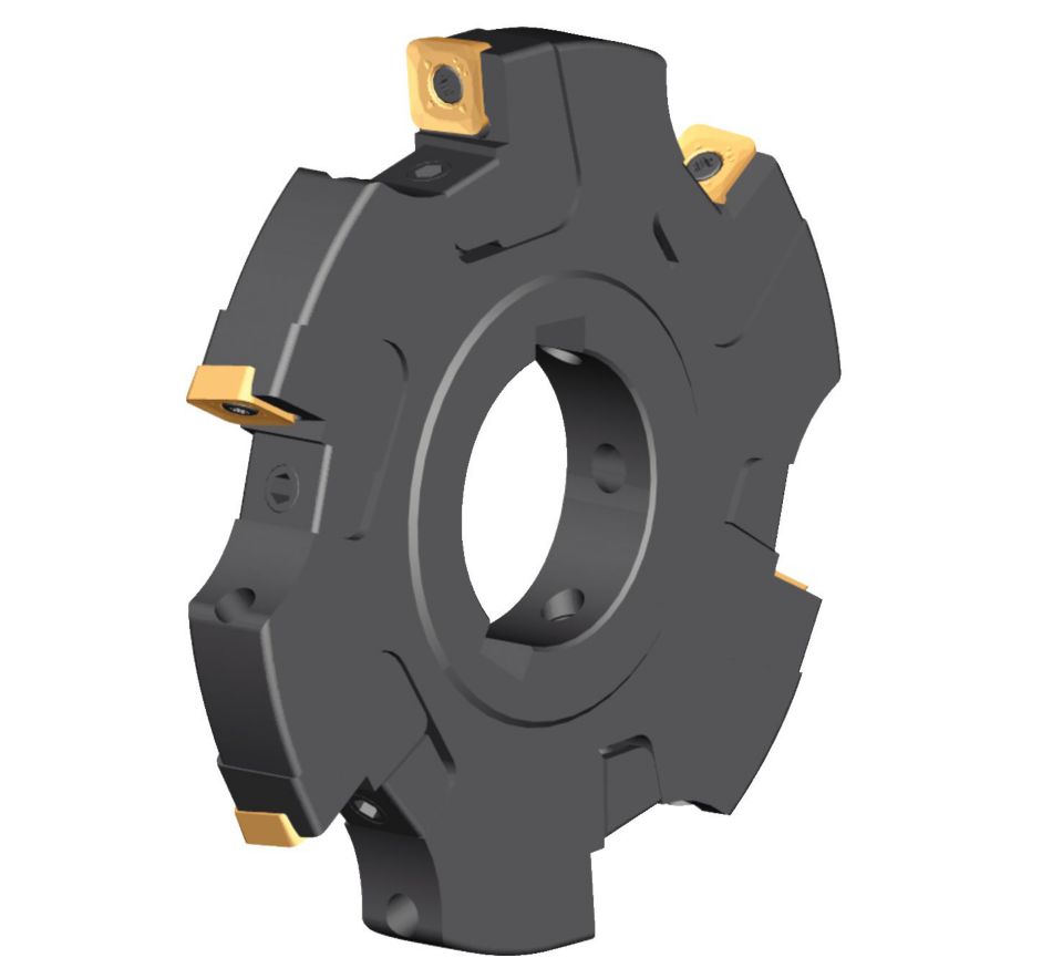

Drawings for 2443505
Material Number2443505
ISO Catalog ID250J18LK90SP10N16K
ANSI Catalog ID250J18LK90SP10N16K
[D1] Effective Cutting Diameter250 mm
[D1] Effective Cutting Diameter9.842 in
[D] Adapter / Shank / Bore Diameter50 mm
[D] Adapter / Shank / Bore Diameter1.9685 in
[D6] Hub Diameter 68.75 mm
[D6] Hub Diameter 2.707 in
[CDX] Radial Maximum Depth of Cut89.87 mm
[CDX] Radial Maximum Depth of Cut3.538 in
[L1] Gage Length15.86 mm
[L1] Gage Length0.627 in
[THUB] Hub Thickness 15.86 mm
[THUB] Hub Thickness 0.624 in
[V] Adjustment Range 1 mm
[V] Adjustment Range0.0394 in
[AP1MAX] 1st Maximum Cutting Depth9.119 mm
[AP1MAX] 1st Maximum Cutting Depth0.359 in
Number of Inserts18
Number of Effective Cutting Edges on Face18
Max RPM10900
Weight Kilograms4.7
  • Rapid adjustment and setting via unique cam adjustment mechanism.
  • Large selection of insert geometries and grades to cut most workpiece materials.
  • Four insert cutting edges.
  • Wide choice of insert radii.
  • Two keyways for staggered mounting.
  • Wiper insert facets for superior surface finishes.
