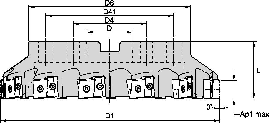

Drawings for 4136382
Material Number4136382
ISO Catalog IDMEGA90D600LN76M8
ANSI Catalog IDMEGA90D600LN76M8
[D1] Effective Cutting Diameter152.4 mm
[D1] Effective Cutting Diameter6 in
[D] Adapter / Shank / Bore Diameter50.8 mm
[D] Adapter / Shank / Bore Diameter2 in
[D6] Hub Diameter 127 mm
[D6] Hub Diameter 5 in
[L] Overall Length 60.33 mm
[L] Overall Length 2.375 in
[AP1MAX] 1st Maximum Cutting Depth25.45 mm
[AP1MAX] 1st Maximum Cutting Depth1.002 in
Number of Inserts7
Weight Pounds10.23
Max RPM9120
