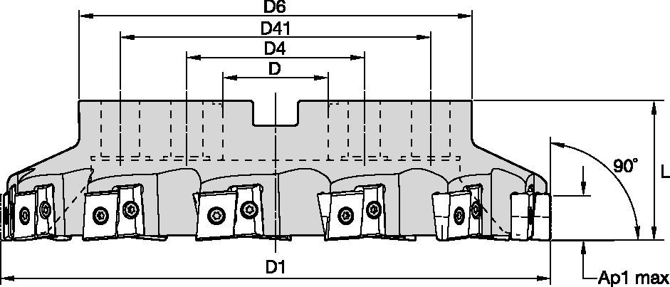

Drawings for 4129657
Material Number4129657
ISO Catalog IDMEGA90D160C07LN22
ANSI Catalog IDMEGA90D160C07LN22
[D1] Effective Cutting Diameter160 mm
[D1] Effective Cutting Diameter6.299 in
[D] Adapter / Shank / Bore Diameter1.5748 in
[D4] Bolt Circle 466.7 mm
[D4] Bolt Circle 32.626 in
[D6] Hub Diameter 130 mm
[D6] Hub Diameter 5.118 in
[L] Overall Length 63 mm
[L] Overall Length 2.48 in
[AP1MAX] 1st Maximum Cutting Depth25.45 mm
[AP1MAX] 1st Maximum Cutting Depth1.002 in
Number of Inserts7
Weight Kilograms4.86
Max RPM8900
