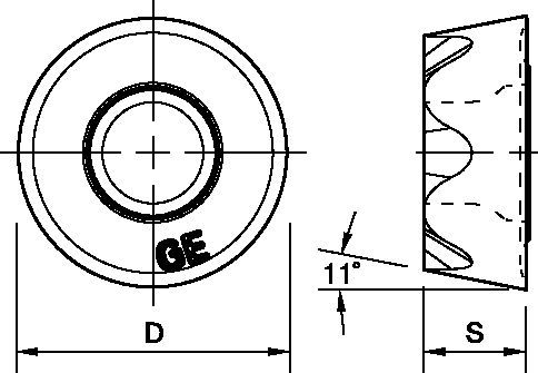

Material Number | 5172844 |
ISO Catalog ID | RPPT43SGE |
ANSI Catalog ID | RPPT43SGE |
Grade | KC725M |
[D] Insert IC Size | 12.7 mm |
[D] Insert IC Size | 0.5 in |
[S] Insert Thickness | 4.76 mm |
[S] Insert Thickness | 0.188 in |
Average Chip Thickness [HM] | 0.114 mm |
Average Chip Thickness [HM] | 0.0045 in |
Insert Number of Indexes | 6 |
