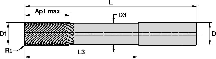

Drawings for 5957725
Material Number5957725
ISO Catalog IDFSDE0600A7DYE
ANSI Catalog IDFSDE0600A7DYE
GradeK600
[D1] Effective Cutting Diameter6 mm
[D1] Effective Cutting Diameter0.2362 in
[D] Adapter / Shank / Bore Diameter6 mm
[D] Adapter / Shank / Bore Diameter0.2362 in
[D3] Neck Diameter 5.64 mm
[D3] Neck Diameter 0.222 in
[AP1MAX] 1st Maximum Cutting Depth12 mm
[AP1MAX] 1st Maximum Cutting Depth0.4724 in
[L3] Usable Length30 mm
[L3] Usable Length1.1811 in
[L] Overall Length 76 mm
[L] Overall Length 2.9921 in
[Re] Corner Radius 0.5 mm
[Re] Corner Radius 0.02 in
[Z] Number of Flutes7
