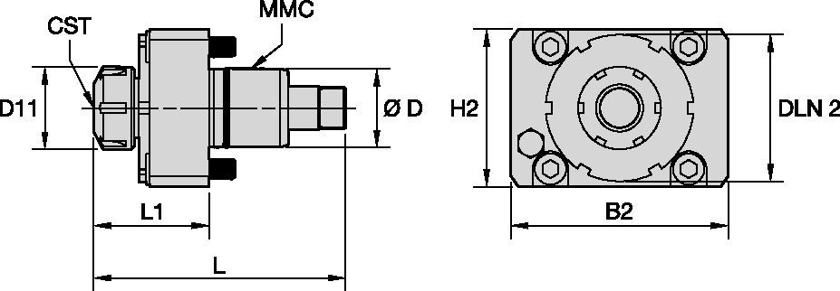

Material Number6588935
ISO Catalog IDTACU001ER25DA61301836
ANSI Catalog IDTACU001ER25DA61301836
[CST] Catalog Collet SeriesER25
Machine Mount Code001
[B2] Overall Width 110 mm
[B2] Overall Width 4.3307 in
[D] Adapter / Shank / Bore Diameter1.5748 in
[D11] Lock Nut Diameter42 mm
[D11] Lock Nut Diameter1.6535 in
Lock Nut Diameter [DLN_2]74.8 mm
[DLN_2] Lock Nut Diameter 22.9449 in
[H2] Overall Height 80 mm
[H2] Overall Height 3.1496 in
[L] Overall Length 127.5 mm
[L] Overall Length 5.0197 in
[L1] Gage Length57 mm
[L1] Gage Length2.2441 in
Torque Machine Spindle Nm32
Coolant Pressure Bar70
Coolant Pressure PSI1000
Coolant DeliveryI/E
[CS1] Coolant Supply Exit SizeM12X1
Max RPM12000
Weight Kilograms2.78
Torque Newton Meters105
Torque Foot Pounds77
