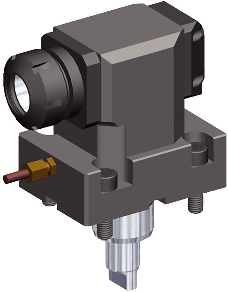

Driven Tool Radial • ER™ • TACU001ER25DR61301838, TACU001ER32DR61301835, TACU001ER25DR61301837
DMG Mori • Driven Tool Radial • ER™ • MMC 001
Material Number6588934
ISO Catalog IDTACU001ER32DR61301835ANSI Catalog IDTACU001ER32DR61301835
Turret Adapted Clamping Units Driven Tool Radial • ER™

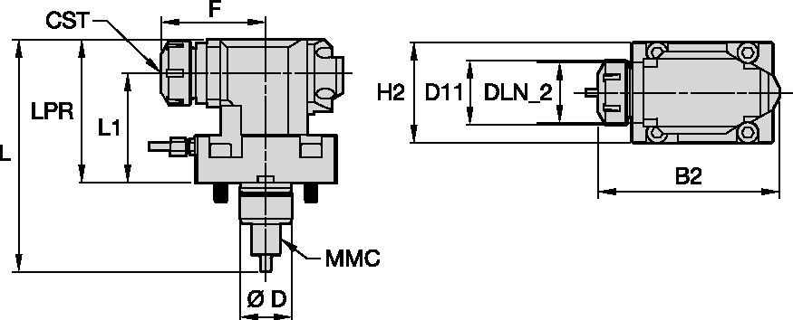

[CST] Catalog Collet SeriesER32
Machine Mount Code001
[B2] Overall Width 138 mm
[B2] Overall Width 5.4331 in
[D] Adapter / Shank / Bore Diameter1.5748 in
[D11] Lock Nut Diameter50 mm
[D11] Lock Nut Diameter1.9685 in
Lock Nut Diameter [DLN_2]47 mm
[DLN_2] Lock Nut Diameter 21.8504 in
[F] F Dimension 78.5 mm
[F] F Dimension 3.0906 in
[H2] Overall Height 78 mm
[H2] Overall Height 3.0709 in
[L] Overall Length 180 mm
[L] Overall Length 7.0866 in
[L1] Gage Length85 mm
[L1] Gage Length3.3465 in
[LPR] Protruding Length 111 mm
[LPR] Protruding Length 4.3701 in
Torque Machine Spindle Nm32
Coolant Pressure Bar70
Coolant Pressure PSI1000
Coolant DeliveryI/E
[CS1] Coolant Supply Exit SizeG 1/8
Max RPM6000
Weight Kilograms6.19
Torque Newton Meters136
Torque Foot Pounds100
