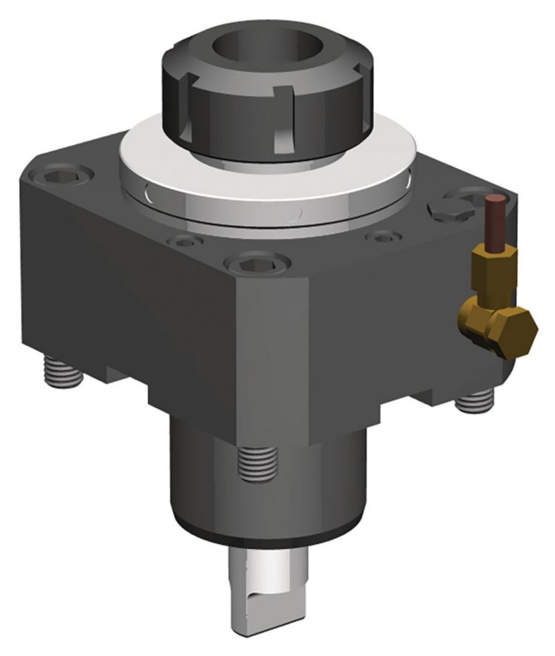

Driven Tool Axial • ER™ • TACU002ER32DA61301864, TACU002ER32DA61301865, TACU002ER40DA61301840, TACU002ER40DA61301841
DMG Mori • Driven Tool Axial • ER™ • MMC 002
Material Number6588939
ISO Catalog IDTACU002ER40DA61301840ANSI Catalog IDTACU002ER40DA61301840
Turret Adapted Clamping Units Driven Tool Axial • ER™
Turret Adapted Clamping Units Driven Tool Axial • ER™+0

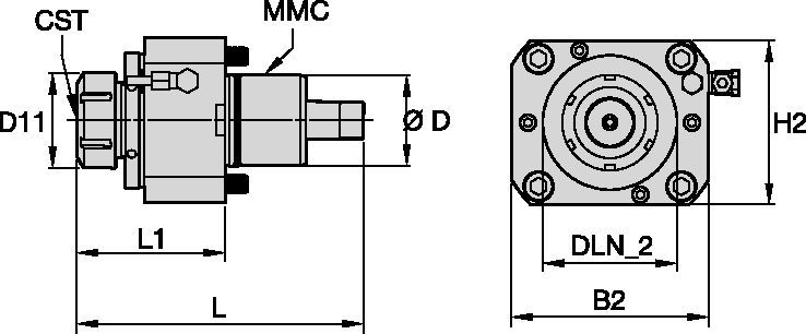

Drawings for 6588939
[CST] Catalog Collet SeriesER40
Machine Mount Code002
[B2] Overall Width 149.9 mm
[B2] Overall Width 5.9016 in
[D] Adapter / Shank / Bore Diameter60 mm
[D] Adapter / Shank / Bore Diameter2.3622 in
[D11] Lock Nut Diameter63 mm
[D11] Lock Nut Diameter2.4803 in
Lock Nut Diameter [DLN_2]89 mm
[DLN_2] Lock Nut Diameter 23.5039 in
[H2] Overall Height 108 mm
[H2] Overall Height 4.252 in
[L] Overall Length 189 mm
[L] Overall Length 7.4409 in
[L1] Gage Length94.5 mm
[L1] Gage Length3.7205 in
Torque Machine Spindle Nm100
Coolant Pressure Bar70
Coolant Pressure PSI1000
Coolant DeliveryI/E
[CS1] Coolant Supply Exit SizeM12X1 & G 1/8
Max RPM6000
Weight Kilograms7.76
Torque Newton Meters176
Torque Foot Pounds130
