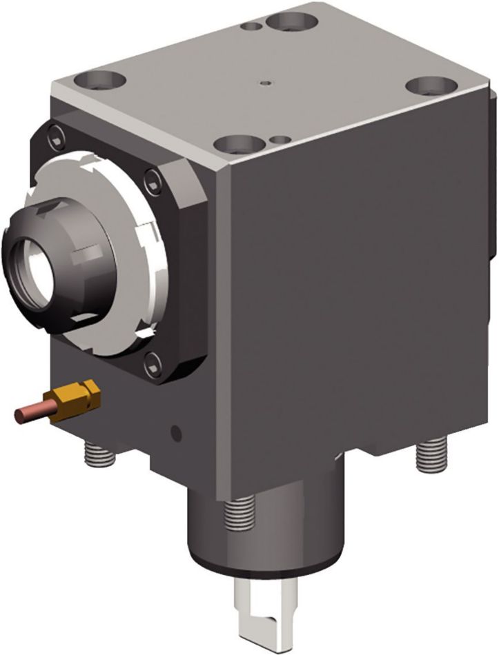

Driven Tool Radial • ER™ • TACU002ER32DR61301863, TACU002ER40DR61301839, TACU002ER40DR61301842
DMG Mori • Driven Tool Radial • ER™ • MMC 002
Material Number6589003
ISO Catalog IDTACU002ER32DR61301863ANSI Catalog IDTACU002ER32DR61301863
Through Coolant: Axial: Drilling
ER Solid Collet
Shank - Screw-On
Collet - ER DIN 6499

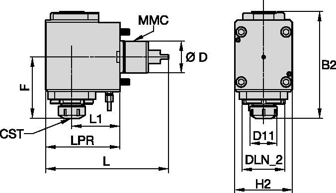

Material Number | 6589003 |
ISO Catalog ID | TACU002ER32DR61301863 |
ANSI Catalog ID | TACU002ER32DR61301863 |
[CST] Catalog Collet Series | ER32 |
Machine Mount Code | 002 |
[B2] Overall Width | 202 mm |
[B2] Overall Width | 7.9528 in |
[D] Adapter / Shank / Bore Diameter | 59.9 mm |
[D] Adapter / Shank / Bore Diameter | 2.3583 in |
[D11] Lock Nut Diameter | 50 mm |
[D11] Lock Nut Diameter | 1.9685 in |
Lock Nut Diameter [DLN_2] | 80 mm |
[DLN_2] Lock Nut Diameter 2 | 3.1496 in |
[F] F Dimension | 116.5 mm |
[F] F Dimension | 4.5866 in |
[H2] Overall Height | 108 mm |
[H2] Overall Height | 4.252 in |
[L] Overall Length | 230 mm |
[L] Overall Length | 9.0551 in |
[L1] Gage Length | 90 mm |
[L1] Gage Length | 3.5433 in |
[LPR] Protruding Length | 139 mm |
[LPR] Protruding Length | 5.472 in |
Torque Machine Spindle Nm | 100 |
Coolant Pressure Bar | 70 |
Coolant Pressure PSI | 1000 |
Coolant Delivery | I/E |
[CS1] Coolant Supply Exit Size | G 1/8 |
Max RPM | 6000 |
Weight Kilograms | 18.63 |
Torque Newton Meters | 136 |
Torque Foot Pounds | 100 |
ER Solid Collet
Shank - Screw-On
Machine Series:- NL/NLX 1500-4000 MC/Y/SMC/SY
- NLX 4000 (High Torque Milling)
- NT 4200-5400
- NZX 2500 (12 Station Turret)
