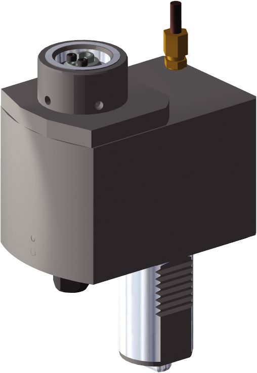

Driven Tool Axial • KM™ • TACU017KM40DA60908155, TACU017KM40DA60908156
Mazak™ • Driven Tool Axial • KM™ • MMC 017
Material Number6391711
ISO Catalog IDTACU017KM40DA60908156ANSI Catalog IDTACU017KM40DA60908156
6391711 - Kennametal
$6,137.62/each
Drawings for 6391711
[CSWS] System Size Workpiece SideKM40
Machine Mount Code017
[B1] Front Clearance 84 mm
[B1] Front Clearance 3.307 in
[B2] Overall Width 123 mm
[B2] Overall Width 4.843 in
[D] Adapter / Shank / Bore Diameter1.575 in
[F] F Dimension 50 mm
[F] F Dimension 1.969 in
[H2] Overall Height 78 mm
[H2] Overall Height 3.07 in
[L] Overall Length 191 mm
[L] Overall Length 7.52 in
[L1] Gage Length112.5 mm
[L1] Gage Length4.429 in
Torque Machine Spindle Nm50
Coolant Pressure Bar70
Coolant Pressure PSI1000
Coolant DeliveryI/E
[CS1] Coolant Supply Exit SizeG 1/8
Max RPM6000
Weight Kilograms7.07
Torque Catalog Newton Meters12-16
Torque Catalog Foot Pounds9-12
