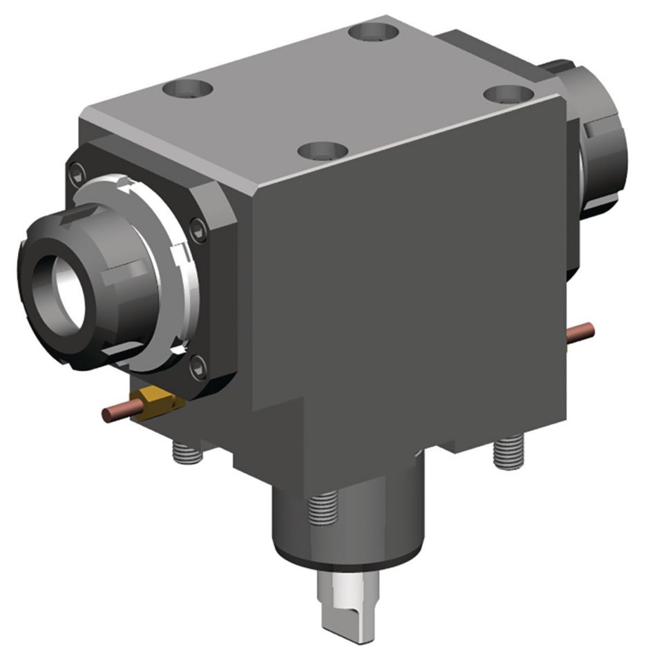

Driven Tool Radial • ER™ • TACU002ER32DR61301866, TACU002ER40DR61301843
DMG Mori • Driven Tool Radial • ER™ • MMC 002
Material Number6588962
ISO Catalog IDTACU002ER40DR61301843ANSI Catalog IDTACU002ER40DR61301843
Turret Adapted Clamping Units Driven Tool Radial • ER™
Turret Adapted Clamping Units Driven Tool Radial • ER™+0

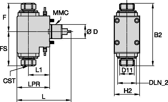

[CST] Catalog Collet SeriesER40
Machine Mount Code002
[B2] Overall Width 260 mm
[B2] Overall Width 10.2362 in
[D] Adapter / Shank / Bore Diameter59.9 mm
[D] Adapter / Shank / Bore Diameter2.3583 in
[D11] Lock Nut Diameter63 mm
[D11] Lock Nut Diameter2.4803 in
Lock Nut Diameter [DLN_2]80 mm
[DLN_2] Lock Nut Diameter 23.1496 in
[F] F Dimension 105.5 mm
[F] F Dimension 4.1535 in
[FS] Secondary F Dimension 131.5 mm
[FS] Secondary F Dimension 5.1772 in
[H2] Overall Height 108 mm
[H2] Overall Height 4.252 in
[L] Overall Length 230 mm
[L] Overall Length 9.0551 in
[L1] Gage Length90 mm
[L1] Gage Length3.5433 in
[LPR] Protruding Length 139 mm
[LPR] Protruding Length 5.472 in
Torque Machine Spindle Nm100
Coolant Pressure Bar25
Coolant Pressure PSI360
Coolant DeliveryI/E
[CS1] Coolant Supply Exit SizeG 1/8
Max RPM6000
Weight Kilograms21.56
Torque Newton Meters176
Torque Foot Pounds130
