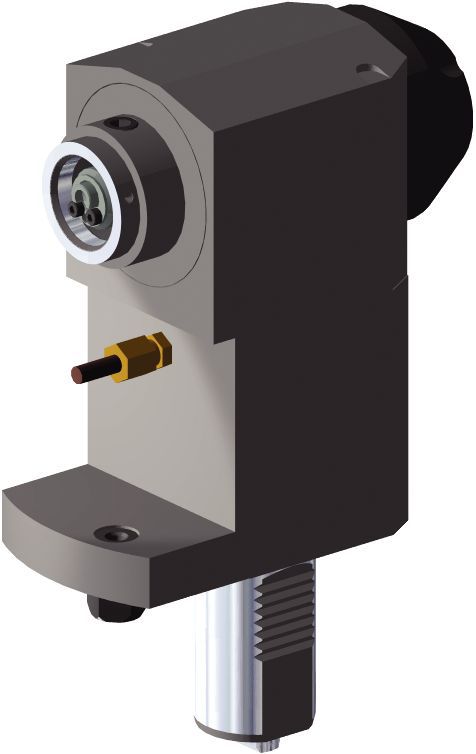

Driven Tool Radial • KM™ • TACU017KM40DR60908157, TACU017KM40DR60908158
Mazak™ • Driven Tool Radial • KM™ • MMC 017
Material Number6391713
ISO Catalog IDTACU017KM40DR60908158ANSI Catalog IDTACU017KM40DR60908158
[CSWS] System Size Workpiece SideKM40
Machine Mount Code017
[B1] Front Clearance 84 mm
[B1] Front Clearance 3.307 in
[B2] Overall Width 156 mm
[B2] Overall Width 6.1417 in
[D] Adapter / Shank / Bore Diameter1.575 in
[F] F Dimension 72.5 mm
[F] F Dimension 2.854 in
[H2] Overall Height 76 mm
[H2] Overall Height 2.992 in
[L] Overall Length 246 mm
[L] Overall Length 9.685 in
[L1] Gage Length130 mm
[L1] Gage Length5.1181 in
[LPR] Protruding Length 168 mm
[LPR] Protruding Length 6.614 in
Torque Machine Spindle Nm50
Coolant Pressure Bar70
Coolant Pressure PSI1000
Coolant DeliveryI/E
[CS1] Coolant Supply Exit SizeG 1/8
Max RPM6000
Weight Kilograms10.12
Torque Catalog Newton Meters12-16
Torque Catalog Foot Pounds9-12
Machine Series:
  • Hyper Quadrex 200, 250 MSY (12 Station Turret)
  • Multiplex 6200, 6200Y, 6250 (12 Station Turret)
