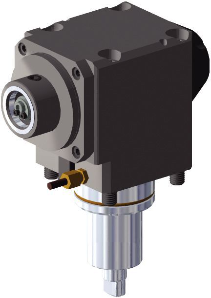

Driven Tool Radial • KM™ • TACU036KM40DR60945569, TACU036KM40DR60945570
Hyundai WIA • Driven Tool Radial • KM™ • MMC 036
Material Number6391608
ISO Catalog IDTACU036KM40DR60945570ANSI Catalog IDTACU036KM40DR60945570
6391608 - Kennametal
$6,259.00/each
Drawings for 6391608
[CSWS] System Size Workpiece SideKM40
Machine Mount Code036
[B2] Overall Width 178 mm
[B2] Overall Width 7.008 in
[D] Adapter / Shank / Bore Diameter65 mm
[D] Adapter / Shank / Bore Diameter2.559 in
[F] F Dimension 99 mm
[F] F Dimension 3.898 in
[H2] Overall Height 94 mm
[H2] Overall Height 3.701 in
[L] Overall Length 228 mm
[L] Overall Length 8.976 in
[L1] Gage Length72 mm
[L1] Gage Length2.835 in
[LPR] Protruding Length 116 mm
[LPR] Protruding Length 4.567 in
Torque Machine Spindle Nm50
Coolant Pressure Bar70
Coolant Pressure PSI1000
Coolant DeliveryI/E
[CS1] Coolant Supply Exit SizeG 1/8
Max RPM6000
Weight Kilograms11.87
Torque Catalog Newton Meters12-16
Torque Catalog Foot Pounds9-12
