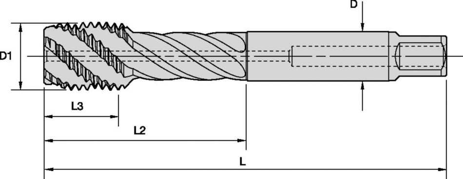

Drawings for 3868978
Material Number3868978
ISO Catalog IDT631M080X125R6HX-D1
ANSI Catalog IDT631M080X125R6HX-D1
GradeKP6525
[D1-TDZ] Thread Diameter SizeM8 X 1.25
[L] Overall Length 90 mm
[L] Overall Length 3.54 in
[L3] Thread Length 13 mm
[L3] Thread Length 0.51 in
[L2] Useable Length 35 mm
[L2] Useable Length 1.38 in
[D] Adapter / Shank / Bore Diameter8 mm
[D] Adapter / Shank / Bore Diameter0.315 in
[Z] Number of Flutes3
Dimension StandardDIN 371
Thread Tolerance Class ISO6HX-I
