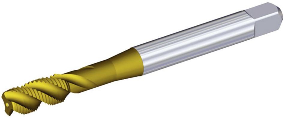

T631 • Metric Sizes • DIN 371, 374, 376 Beyond Right Hand Spiral Flute HSS-E-PM for Blind Holes with Axial Coolant Holes
Beyond™ Spiral-Flute HSS-E-PM Taps • Blind Holes
Material Number3868982
ISO Catalog IDT631M160X200R6HX-D6ANSI Catalog IDT631M160X200R6HX-D6
T631 DIN Metric Threading - 3868982 - Kennametal
$122.48/each
  • Threading: Blind HoleThreading: Blind Hole
  • Class of Fit: 6HXClass of Fit: 6HX
  • DIN number 371DIN number 371
  • DIN number 374DIN number 374
  • DIN number 376DIN number 376
  • Chamfer Form C (2–3)Chamfer Form C (2–3)
  • HSS-E-PMHSS-E-PM
  • Through Coolant: Axial: TappingThrough Coolant: Axial: Tapping
  • Manufacturer’s Specs: MFManufacturer’s Specs: MF
  • Tapping Helix Angle: 45°Tapping Helix Angle: 45°
Drawings for 3868982
GradeKP6525
[D1-TDZ] Thread Diameter SizeM16 X 2
[L] Overall Length 110 mm
[L] Overall Length 4.33 in
[L3] Thread Length 20 mm
[L3] Thread Length 0.79 in
[L2] Useable Length 51 mm
[L2] Useable Length 2.01 in
[D] Adapter / Shank / Bore Diameter0.4724 in
[Z] Number of Flutes4
Dimension StandardDIN 376
Thread Tolerance Class ISO6HX-I
  • HSS-E-PMHSS-E-PM
KP6525
KP6525
Coated HSS-E-PM. PVD — heat- and wear-resistant high vanadium — cobalt powder metal HSS substrate coated with wear-resistant TiCN base layer and low-friction TiN top layer. Use in steel, cast iron, and cast aluminum with silicon.
