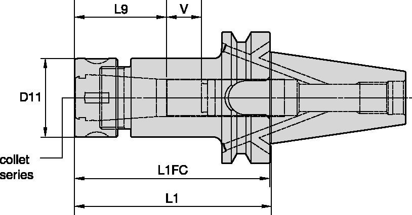

Drawings for 3856667
Material Number3856667
ISO Catalog IDBTKV50BTG150100M
ANSI Catalog IDBTKV50BTG150100M
[CST] Catalog Collet SeriesTG150
[D11] Lock Nut Diameter85 mm
[D11] Lock Nut Diameter3.3465 in
[L1] Gage Length100 mm
[L1] Gage Length3.937 in
Gage Length Face Contact [L1FC]98.5 mm
Gage Length Face Contact [L1FC]3.878 in
[L9] Clamping Length 78 mm
[L9] Clamping Hole Length 3.0709 in
[V] Adjustment Range 13 mm
[V] Adjustment Range 0.5118 in
Stop Screw ID Drive Size4 mm & 5/32
Torque Catalog Newton Meters271
Weight Kilograms4.43
