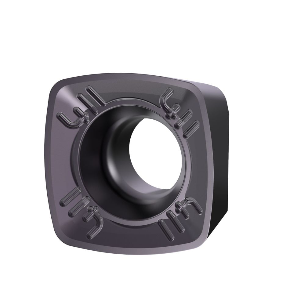

7792VXD09 Series • Carbide Insert • XDLT-D411 • Light Machining
High-feed copy milling insert with four cutting edges, precision ground.
Material Number5652249
ISO Catalog IDXDLT090412ERD411ANSI Catalog IDXDLT090412ERD411
7792VX09 IN XDLT-411 Milling - 5652249 - Kennametal
GradeSP6519
[D] Insert IC Size9.525 mm
[D] Insert IC Size0.375 in
[LI] Insert Length 9.525 mm
[LI] Insert Length 0.375 in
[S] Insert Thickness4.75 mm
[S] Insert Thickness0.187 in
[Rε] Corner Radius 1.2 mm
[Rε] Corner Radius 0.047 in
Average Chip Thickness [HM]0.05 mm
Average Chip Thickness [HM]0.002 in
[RT] Theoretical Corner Radius Programing2.27 mm
[RT] Theoretical Corner Radius Programing0.089 in
SP6519
SP6519
Coated carbide grade with PVD TiAlN nano-composite coating on a tough substrate. Primarily for use in general and heavy machining, dry and wet.
  • Precision ground insert for best surface finish
  • Single-sided copy milling insert for machining of steels, stainless steel and high-temperature alloys
