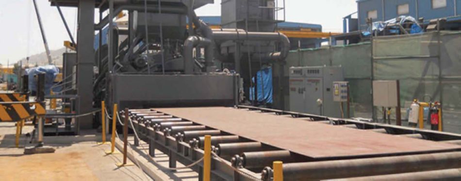

Extreme Furnace Wear
Conditions inside the furnaces are extreme. Temperatures exceed 600° C, and the high-impact abrasions caused by shot blasting lead to frequent wear and replacement of AR 400 plates used inside furnaces. Typically, these plates last only five weeks.

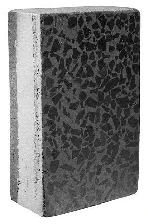

In one shot blast furnace, existing AR 400 plates were swapped out and replaced with KenCast plates. Lasting up to six times longer than standard wear solution depending upon the application and site conditions, KenCast is renowned for its exceptional wear and abrasion resistance, combining an embedded tungsten carbide grit layer on the wear surface cast into a steel base material. This unique composition enabled the KenCast plates to endure the harsh conditions found at this site's blast furnace, which was far better than the AR 400 standard plates used there.
Shot Blast Furnace Site
