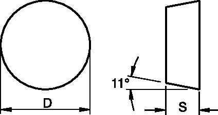

Indexable Ceramic Inserts • KIPR
Material Number100001944
- Four grades and three insert sizes with positive clearances for ramping.
- For machining high temp alloys, PH stainless, stainless steels, and hardened materials.
