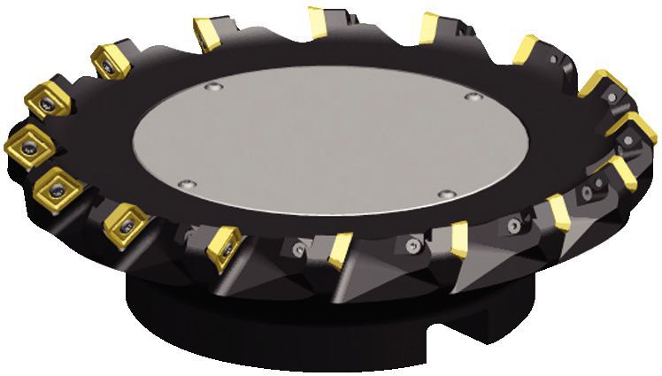

Beyond BLAST™ KSSM™ 45° Shell Mills
  • Face MillingFace Milling
Drawings for 4147355
Material Number4147355
ISO Catalog ID125B12RS45SE14BB
ANSI Catalog ID125B12RS45SE14BB
[D1] Effective Cutting Diameter125 mm
[D1] Effective Cutting Diameter4.921 in
[D1MAX] Maximum Cutting Diameter138.67 mm
[D1MAX] Maximum Cutting Diameter5.46 in
[D] Adapter / Shank / Bore Diameter1.5748 in
[D6] Hub Diameter 90 mm
[D6] Hub Diameter 3.543 in
[L] Overall Length 63 mm
[L] Overall Length 2.48 in
[AP1MAX] 1st Maximum Cutting Depth6.6 mm
[AP1MAX] 1st Maximum Cutting Depth0.26 in
Number of Inserts12
Weight Kilograms3.35
Max RPM11600
