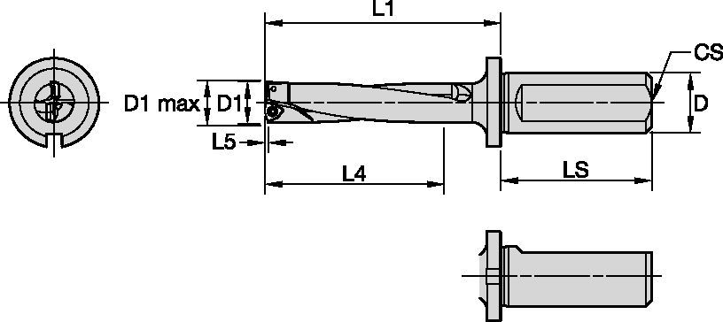

Material Number | 6075724 |
ISO Catalog ID | DFSP175R4WB25M |
ANSI Catalog ID | DFSP175R4WB25M |
[D] Adapter / Shank / Bore Diameter | 25 mm |
[D] Adapter / Shank / Bore Diameter | 0.984 in |
[D1] Drill Diameter M | 17.5 mm |
[D1] Drill Diameter M | 0.689 in |
[D1MAX] Drill Diameter Maximum | 18.5 mm |
[D1MAX] Drill Diameter Maximum | 0.7283 in |
[L1] Insert Gage Length | 99 mm |
[L1] Insert Gage Length | 3.898 in |
[L4] Maximum Drilling Depth | 70 mm |
[L4] Maximum Drilling Depth | 2.756 in |
[L5] Drill Point Length | 0.49 mm |
[L5] Drill Point Length | 0.019 in |
[LS] Shank Length | 56 mm |
[LS] Shank Length | 2.205 in |
Gage Insert | SPGX0603. |
Gage Insert 2 | DFT0303. |

Dimension
D | LS | CS |
20 | 45 | — |
32 | 58 | R 1/4 BSP * |
40 | 68 | R 1/4 BSP |
50 | 68 | R 1/4 BSP |
D | LS |
20 | 50 |
25 | 56 |
32 | 60 |
40 | 70 |
