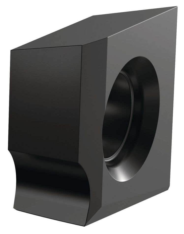

Inserts for Fix-Perfect™ 90° • SPHX1205-W • Finishing • GN
Indexable Inserts • SPHX1205... • Finishing
Material Number1819846
ISO Catalog IDSPHX1205PCFRGN1WBANSI Catalog IDSPHX1205PCFRGN1WB
- K Cast Iron
Material Number | 1819846 |
ISO Catalog ID | SPHX1205PCFRGN1WB |
ANSI Catalog ID | SPHX1205PCFRGN1WB |
Grade | KCK15 |
[L10] Insert Cutting Edge Length | 11 mm |
[L10] Insert Cutting Edge Length | 0.4331 in |
[S] Insert Thickness | 5.2 mm |
[S] Insert Thickness | 0.2047 in |
[BS] Corner Facet Length | 2 mm |
[BS] Corner Facet Length | 0.0787 in |
Average Chip Thickness [HM] | 0.02 mm |
Average Chip Thickness [HM] | 0.0008 in |
Cutting Edges per Insert | 1 |
