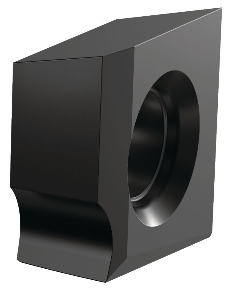

Inserts for Fix-Perfect™ 90° • SPHX1205-W • Finishing • GN
Indexable Inserts • SPHX1205... • Finishing
Material Number2227156
ISO Catalog IDSPHX1205PCERGN1WBANSI Catalog IDSPHX1205PCERGN1WB
- P Steel
- M Stainless Steel
- K Cast Iron
- S High-Temp Alloys
Material Number | 2227156 |
ISO Catalog ID | SPHX1205PCERGN1WB |
ANSI Catalog ID | SPHX1205PCERGN1WB |
Grade | KCPK30 |
[L10] Insert Cutting Edge Length | 11 mm |
[L10] Insert Cutting Edge Length | 0.4331 in |
[S] Insert Thickness | 5.2 mm |
[S] Insert Thickness | 0.2047 in |
[BS] Corner Facet Length | 2 mm |
[BS] Corner Facet Length | 0.0787 in |
Average Chip Thickness [HM] | 0.04 mm |
Average Chip Thickness [HM] | 0.0016 in |
Cutting Edges per Insert | 1 |
- Steel
- Stainless Steel
- Cast Iron
- High-Temp Alloys
KCPK30
Coated carbide grade with CVD multilayer (TiN/TiCN/Al2O3) and advanced Beyond™ post-coat treatment. Substrate is very tough. KCPK30 has a wide application area in general and roughing milling of steels and cast irons. Performs best dry, but can also be used wet.
