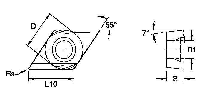

Drawings for 7154823
Material Number7154823
ISO Catalog IDDCGT11T301MRPPS
ANSI Catalog IDDCGT32502MRPPS
GradeKCM25S
[D] Insert IC Size9.525 mm
[D] Insert IC Size0.375 in
[L10] Insert Cutting Edge Length11.628 mm
[L10] Insert Cutting Edge Length0.4578 in
[S] Insert Thickness3.97 mm
[S] Insert Thickness0.1563 in
[Rε] Corner Radius 0.1 mm
[Rε] Corner Radius 0.004 in
[D1] Insert Hole Size 4.4 mm
[D1] Insert Hole Size 0.1732 in
