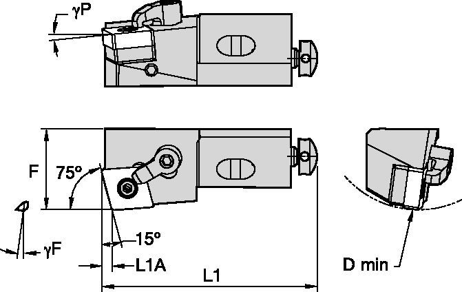

Drawings for 3346238
Material Number3346238
ISO Catalog IDMCKNR12CA12
ANSI Catalog IDMCKNR12CA4
[DM] Minimum Bore Diameter 50 mm
[DM] Minimum Bore Diameter 1.9685 in
[F] F Dimension 20 mm
[F] F Dimension 0.7874 in
[L1] Tool Length 55 mm
[L1] Tool Length 2.1654 in
[L1A] L1 A Dimension 3.08 mm
[L1A] L1 A Dimension 0.1213 in
[GAAP] Axial Rake Angle5
