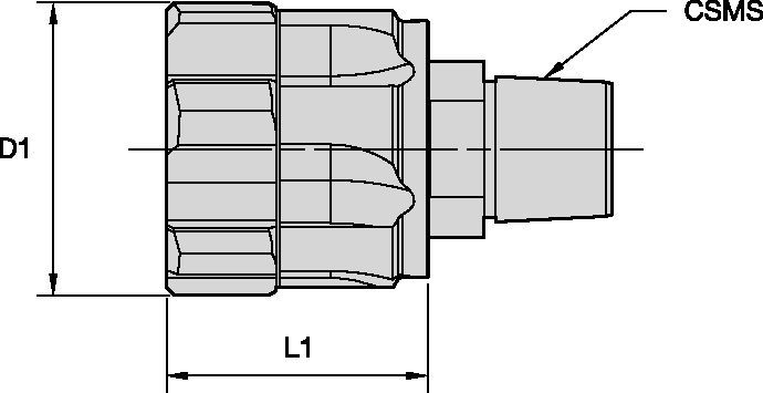

[CSMS] System Size Machine SideKST350
[D1] Reamer Diameter Minimum42 mm
[D1] Reamer Diameter Minimum1.6535 in
[L1] Gage Length20.4 mm
[L1] Gage Length0.8031 in
[Z] Number of Flutes8
