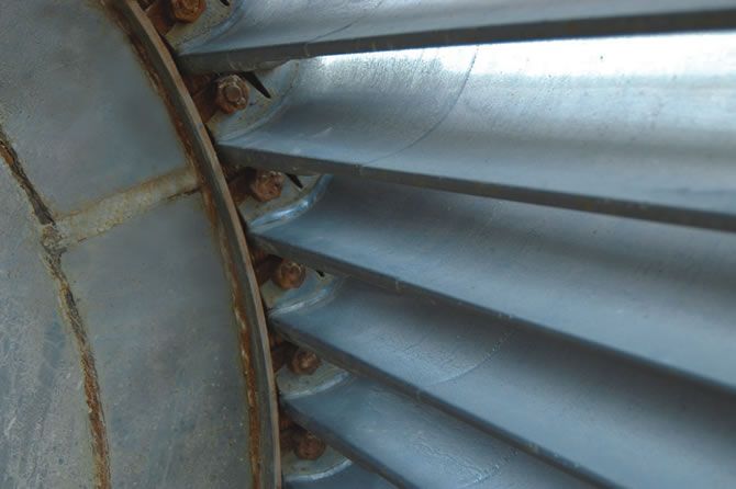

Extreme erosion, abrasion, and temperatures are prevalent throughout coal power generation processes. Conforma Clad and UltraFlex are extremely thin and lightweight compared to the thickness of steel needed to achieve the same performance.
Use our cladding in areas where you want to extend the time between maintenance cycles from months to years.
  • Lightweight, effective treatment for fan blades, blade liners, housings, and other fan components. Applications include induced-draft and forced-draft fans used in hot primary, gas recirculation, or exhauster locations.
