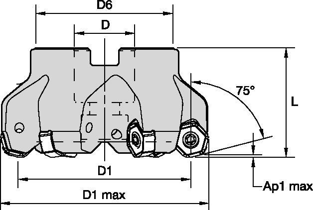

제품 번호 | 4136411 |
ISO 카탈로그 ID | KSHRHF150HN43F3 |
ANSI 카탈로그 ID | KSHRHF150HN43F3 |
[D1] Effective Cutting Diameter | 38.1 mm |
[D1] Effective Cutting Diameter | 1.5 in |
[D1MAX] Maximum Cutting Diameter | 51.25 mm |
[D1MAX] Maximum Cutting Diameter | 2.018 in |
[D] Adapter / Shank / Bore Diameter | 19.05 mm |
[D] Adapter / Shank / Bore Diameter | 0.75 in |
[D6] Hub Diameter | 44.45 mm |
[D6] Hub Diameter | 1.75 in |
[L] Overall Length | 40 mm |
[L] Overall Length | 1.575 in |
[AP1MAX] 1st Maximum Cutting Depth | 1.65 mm |
[AP1MAX] 1st Maximum Cutting Depth | 0.065 in |
Number of Inserts | 5 |
Weight Pounds | 0.75 |
Max RPM | 16700 |
