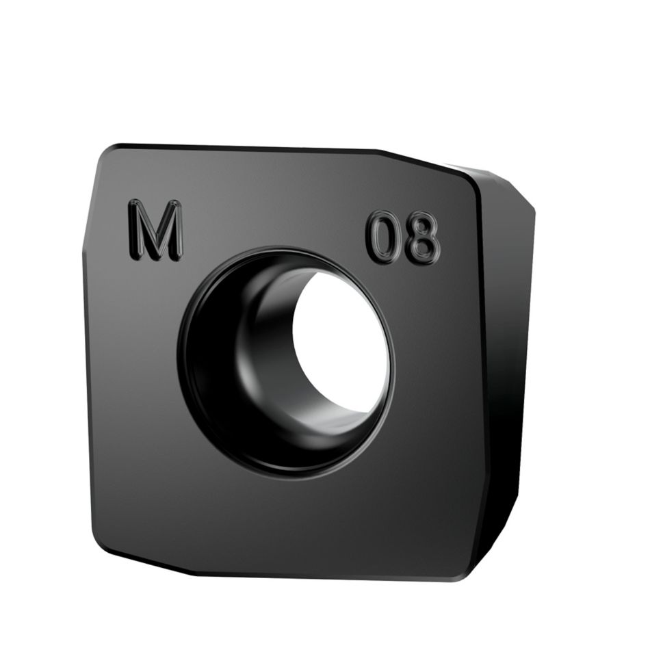

7792VXD12 Series • Carbide Insert • XDPW-M • Heavy Machining
High-feed copy milling insert with four cutting edges.
Material Number7142774
ISO Catalog IDXDPW120508SRMANSI Catalog IDXDPW120508SRM

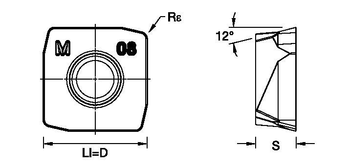

Drawings for 7142774
GradeKCPM40
[D] Insert IC Size12.15 mm
[D] Insert IC Size0.478 in
[LI] Insert Length 12.153 mm
[LI] Insert Length 0.4785 in
[S] Insert Thickness5.56 mm
[S] Insert Thickness0.2189 in
[Rε] Corner Radius 0.8 mm
[Rε] Corner Radius 0.031 in
[RT] Theoretical Corner Radius Programing2.46 mm
[RT] Theoretical Corner Radius Programing0.0969 in
KCPM40
KCPM40
Coated carbide grade with an advanced PVD TiAlN/AlCrN coating. Tough substrate with excellent capability at higher temperatures. KCPM40™ is the first choice for milling steel and stainless steel. Good thermal shock resistance makes this grade ideal for both wet and dry machining. Primarily for use in general and heavy machining.
  • Pressed-to-size, for lowest cost per cutting edge.
  • Single-sided copy milling insert for machining of steels, stainless steel, and high-temperature alloys.
