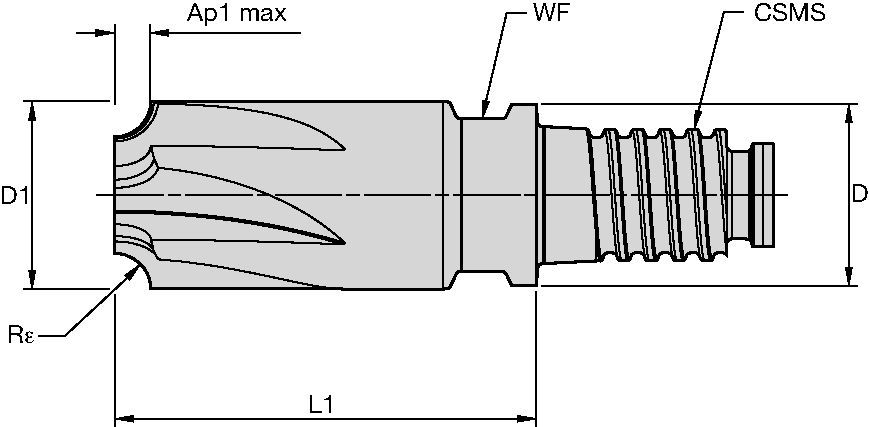

Drawings for 6127715
Material Number6127715
ISO Catalog IDXRDA0625Y6CUE
ANSI Catalog IDXRDA0625Y6CUE
GradeKCPM15
Adapter Style Machine SideDUO-LOCK
[D] Adapter / Shank / Bore Diameter15.375 mm
[D] Adapter / Shank / Bore Diameter0.6053 in
[AP1MAX] 1st Maximum Cutting Depth3.048 mm
[AP1MAX] 1st Maximum Cutting Depth0.12 in
[L1] Gage Length35.848 mm
[L1] Gage Length1.4113 in
[CSMS] System Size Machine SideDL16
[WF] Width of Flat 13 mm
[WF] Width of Flat 0.5118 in
[Re] Corner Radius 3.05 mm
[Re] Corner Radius 0.12 in
[Z] Number of Flutes6
[D1] Effective Cutting Diameter15.875 mm
[D1] Effective Cutting Diameter0.625 in
  • Side/Shoulder Milling: RadiusSide/Shoulder Milling: Radius
  • Helix Angle: 0°Helix Angle: 0°
