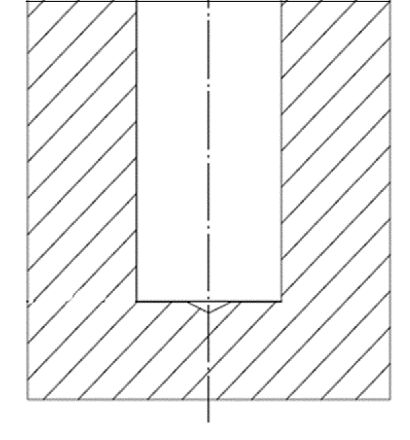

Numerous other applications for flat-bottomed drills exist, though, many of which can't be machined with an end mill. Why not, you ask? After all, end mills have a similar shape, so they should be able to cut the same forms as flat bottom drills, right? The answer is a definitive "not really." That’s because end mills are designed to cut radially—from side to side, in other words—not axially like a drill. Yes, center-cutting end mills are fairly effective at plunging, but at nowhere near the rate of a drill bit. An end mill’s thicker web and slower spiral hinder chip evacuation during holemaking operations while also raising cutting forces significantly. Nor is an end mill’s end perfectly flat, but rather slightly concave, and leaves a raised dimple in the bottom of any hole that must then be removed with a drill or boring tool. Finally, end mills are not available in the long lengths common to drill bits, limiting their holemaking capabilities.

So what are those other applications? Counterboring is one, but so is the drilling of blind, flat-bottom holes. These are often used to house electronic components such as sensors, or to position a pin or shaft in an assembly. Using a flat bottom drill to punch holes in thin workpieces or stacks of thin plates (a common practice in the heat exchanger industry) tends to reduce the inevitable burr on the part's exit side. A similar argument can be made for holemaking in tubes and pipes as well as drilling into angled surfaces, or breaking through into intersecting holes during hydraulic manifold production.
