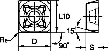

- Honed insert edges.
- Four cutting edges.

KC505M
Coated carbide with PVD TiAlN. KC505M is a highly wear-resistant grade primarily used for light maching applications in steel and hardened steels.
