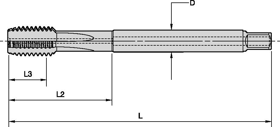

      T641 • Metric Sizes • DIN 371, 376 HP HSSE-PM taps for thru and blind holes • Cast & Ductile Iron with Axial Coolant Hole
      Beyond™ Straight-Flute HSS-E-PM Taps • Blind Holes
      SAP Material Number 4035525
      ISO Catalog Number T641M050X080R6HX-D1
      ANSI Catalog Number T641M050X080R6HX-D1
      Grade KP6525
      [D1-TDZ] Thread Diameter Size M5 X 0,8
      [L] Overall Length 70.0000 mm
      [L] Overall Length 2.760 in
      [L3] Thread Length 10.0000 mm
      [L3] Thread Length .3900 in
      [L2] Useable Length 25.0000 mm
      [L2] Useable Length .9800 in
      [D] Adapter / Shank / Bore Diameter 6.0 mm
      [D] Adapter / Shank / Bore Diameter .2362 in
      [Z] Number of Flutes 3
      Dimension Standard DIN 371
      Thread Tolerance Class ISO 6HX-I
