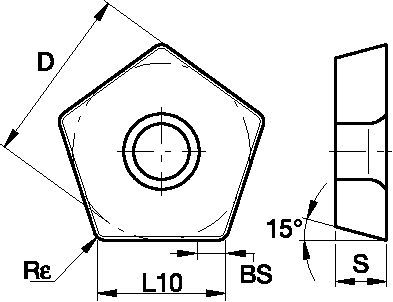

KC715M
KC715M is ideal for dry machining. The deformation substrate combined with a PVD coating can handle high temperatures and higher surface speeds. It is promarily for use in light and general machining of steels, stainless steel and cast steel.
