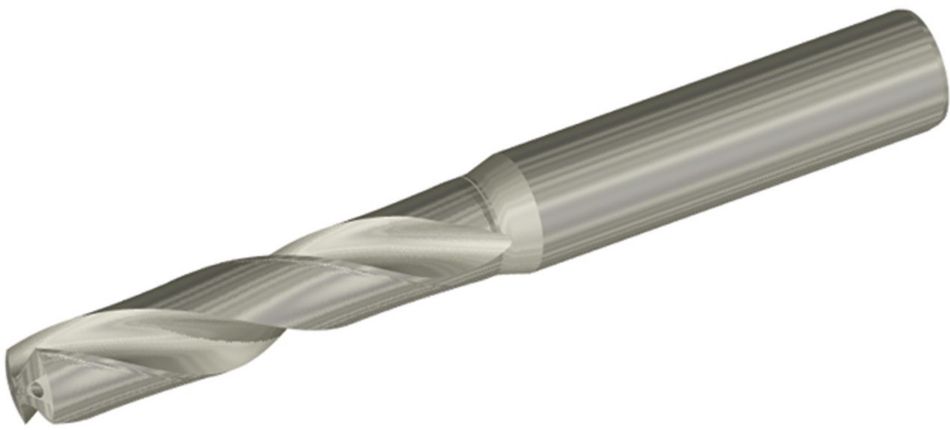

      SAP Material Number 1961466
      ISO Catalog Number K285A05000
      ANSI Catalog Number K285A05000
      Grade K715
      [D1] Drill Diameter M 12.7000 mm
      [D1] Drill Diameter M .5000 in
      [L] Overall Length 118.0080 mm
      [L] Overall Length 4.646 in
      [L3] Flute Length 70.0020 mm
      [L3] Flute Length 2.756 in
      [L4] Maximum Drilling Depth 55.6000 mm
      [L4] Maximum Drilling Depth 2.189 in
      [L5] Drill Point Length 2.3370 mm
      [L5] Drill Point Length .0920 in
      [LS] Shank Length 45.491 mm
      [LS] Shank Length 1.791 in
      [D] Adapter / Shank / Bore Diameter 12.7 mm
      [D] Adapter / Shank / Bore Diameter .5 in
      • HP Drills with Through Coolant for High-Temperature Alloys.
      • Material-specific SC Drill for machining high-temperature-resistant alloys such as titanium alloys and nickel-based alloys in aerospace applications.
      • Straight Cutting Edge for optimized chip formation with less stress and heat generation.
      • Rigid wedge at the cutting corner to withstand high thermal and mechanical stress.
      • K715™ Grade is a specified, uncoated 9% cobalt fine-grain carbide that helps to prevent built-up edge.
